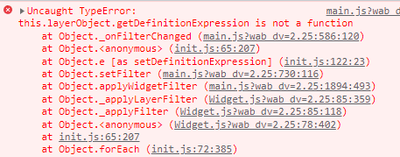

I get the same error

Updated to WAB 2.24 on Enterprise 10.9.1 and still getting the same failure.

Still getting this bug in AGOL...... August 2023
