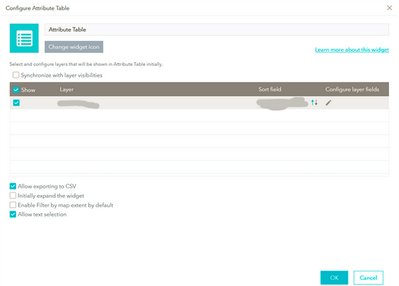

Yes, you need to use the attribute table widget in web app builder to reorder the fields. In the editing view of your app edit the attribute table widget, then use the pencil in the "configure fields" section to edit the order (and aliases) of your fields. You can also set the visibility.
