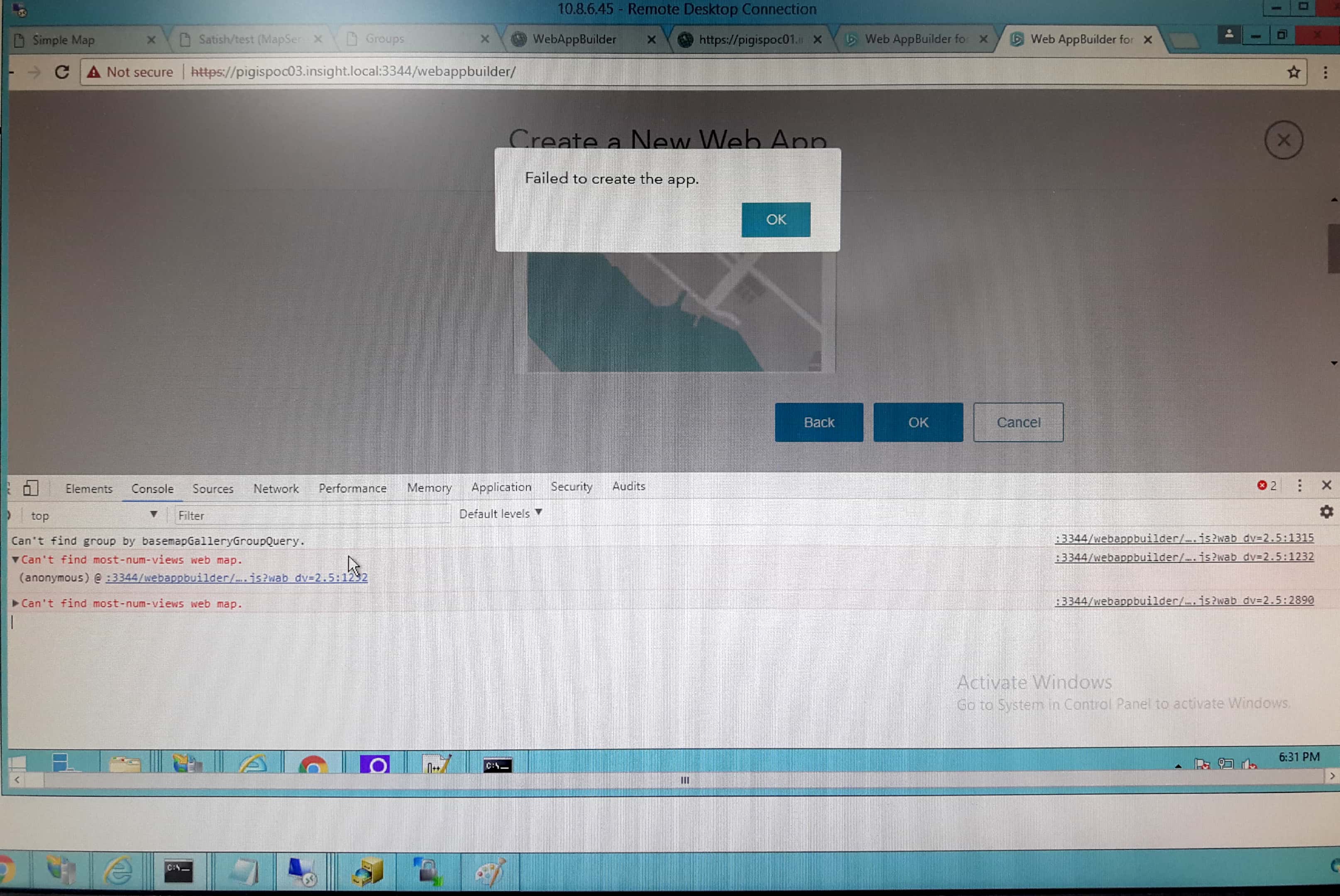

Hi,
I have registered my Web AppBuilder with the portal which is joined with another portal (Portal A as Primary and Portal B as StandBy). Both portal server are configured to a single Web Adapter and don't have internet connectivity.ArcGIS javascript API 3.21 configured locally and "env.js" file configured accordingly for WAB 2.5.
While creating the 2D App (After entering Title & description and click on "OK" button, I am getting the error "Failed to Create the app".
Create app error

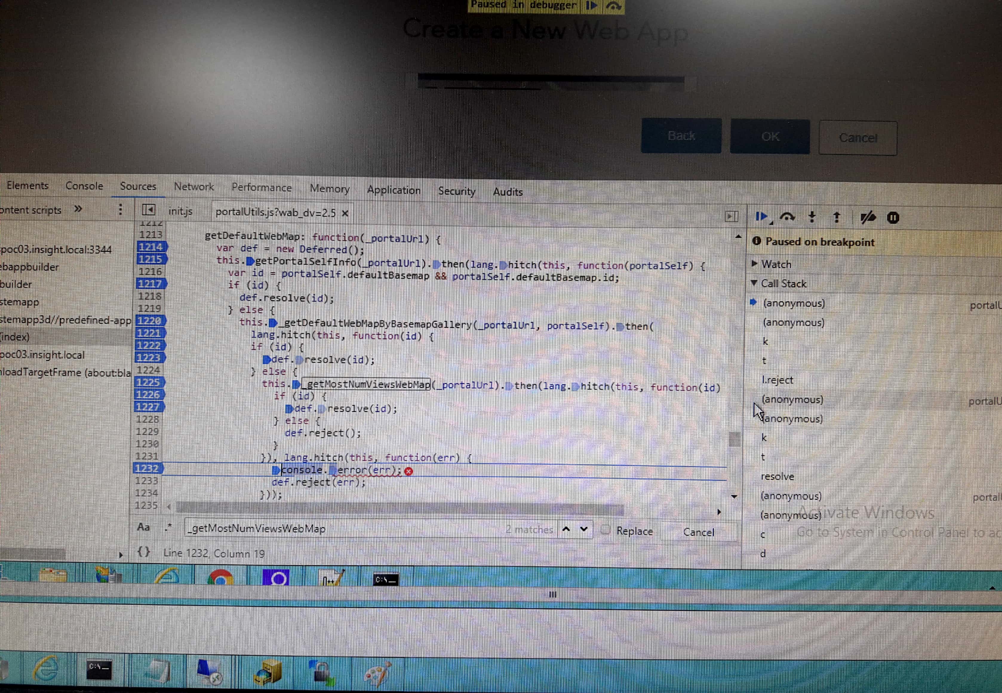

while debugging I found that the error was coming from "arcgis_web_appbuilder_2.5\WebAppBuilderForArcGIS\client\stemapp\jimu.js\portalUtils.js". It was throwing error on "getDefaultWebMap" function (Line No: 1213) . Where "id" is coming "Undefiend"
Error at portalUtils.js
I am not able to figure it out, why it is not generating "id" from the above function.
Kindly anyone help me on this!!!

One thing I notice that, In Portal, Though i am connected to internet but i am not able to see basemap gallery from the map viewer. The above function is looking for ArcGIS portal ID, Which is not generating.
