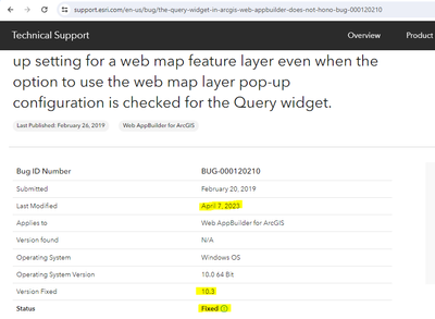

Here is the result from ESRI if anyone else has this issue:
"On our call, we were able to demonstate the Query widget not honoring custom arcade expressions in the feature pop-ups.  We found an exising defect that addresses this issue.  I have attached the following defect to this case.
BUG-000120210: The Query widget in the Web AppBuilder for ArcGIS application does not honor Arcade expressions configured in the pop-up setting for a web map feature layer even when the option to use the web map layer pop-up configuration is checked for the Query widget.
Our Software Developers review bugs to determine further action to address these types of issues in future releases of the software. Currently, the public status of the defect is "In Product Plan" For the most up-to-date information on this request, you may track it by referencing BUG-000120210."
AnjulPandey
BUG-000120210  Although this bug marked as fixed, problem still persists in ArcGIS Enterprise 10.8.1 WebApp Builder.
Query widget does not honor Arcade expressions configured in the pop-up setting for a web map feature layer even when the option to use the web map layer pop-up configuration is checked for the Query widget

Did you ever hear more about the fix? I'm running into this issue too.
I'm wondering if they meant version 11.3...
