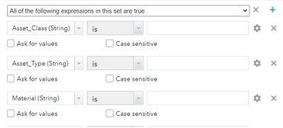

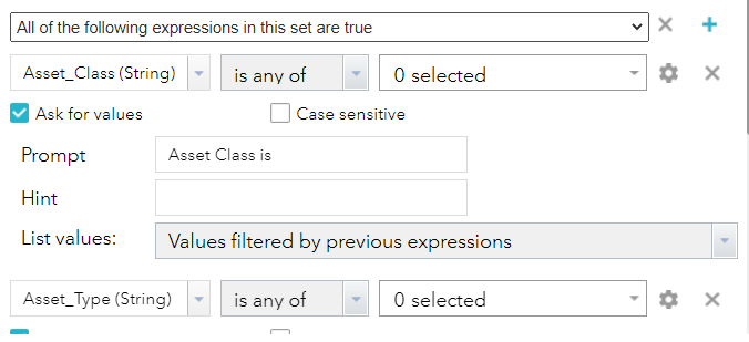

I have set a Query criteria within the Query widget which holds several fields requiring user input.
If I go into the configure query widget options and touch a query that already exists I'm finding that my defined query is altered and I receive an error requiring me to 'set filter correctly'.
I set the expressions up with 4 expressions which are 'is any of' and 'ask for values' selected.
I can save this and it works within the app.
When I go into the widget settings and click on an existing query the filter is automatically changed removing all of the 'is any of' and removing the 'ask for values', hence not allowing me to get out of the widget before fixing the expression back to the original state.
It is fine as long as I never go into the old query, however if I am making a new query I often click into an old one to see the standards I used when creating it.  I've already spent a tonne of time creating these queries so it would be great to not have to constantly rebuild them.

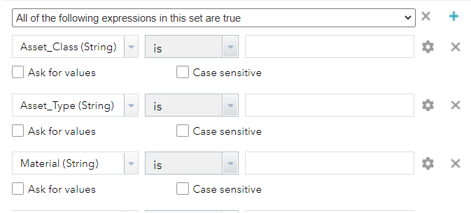

frhilyana_geo11
I think it is like a glitch. what I did when that happened:
1. click the data source setting (Just click, do not set anything)
2. Then, click the results tab (again, just click. do not set anything)
3. Next, click the filters tab
4. lastly click the Query Criteria setting and all of the previous settings were able to be retrieved back.
attached together is the screenshot.
KellyKnapp35
Hi @frhilyana_geo11 , I tried that but couldn't get the same results.  I found that just Canceling out of the Query configuration will save my criteria.  But it still will give me the error if I go back again.  It must be a bug!
