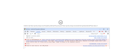

The proxy page worked if I visit the link directly and get JSON response. But if the link is accessed through web appbuilder, then I got error message stating "unable to load <url>, status: 0".
In Fiddler, I can see that the proxy request gets proper JSON response.

For me, it was a mixed content problem.
When I accessed the Web AppBuilder app using https instead of http the error was resolved.

I was trying try to access an encrypted web map ("https") from unsecured Web AppBuilder ("http"). Once I switched to running WAB from https://localhost the error resolved.
Hope that helps.
