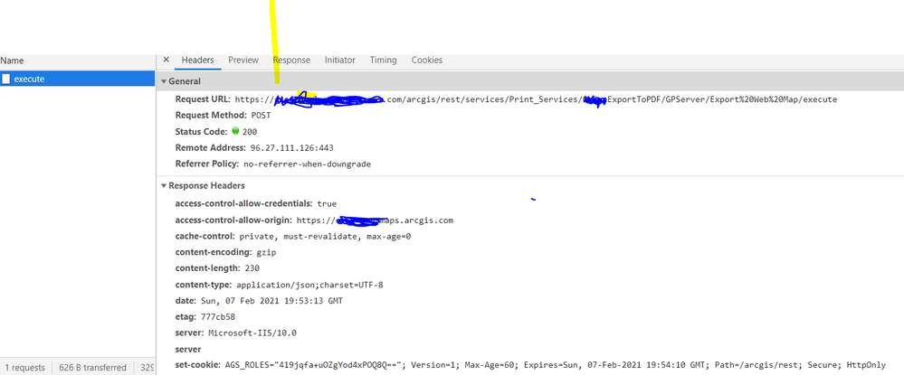

I'm getting a 200 status code when I look at the Developer Tools, so it seems like the request was successful, but clearly something is not working.
