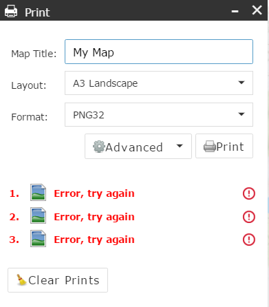

Hello, I got the following error message when I was trying to use WAB built-in Print Widget with ESRI printing service (Task: Export Web Map Task ). when I hover the error, it told me the "Error executing tool ....... Unable to connect to map server https://..../mymap/myservice/MapServer. ...Failed to execute Web Map Export task"
The map service can be accessed via rest-end point and the web map is shared at org level and can be seen from the application. Are there any other things I need to config to make it work? Thanks for your help!

Alex,
   Are you mixing https and http urls? Are you printing secured layers? Do you have a proxy setup?

Thanks Robert. Yes, the layers from our clients are secured so https://.....
here is what I have for the httpProxy part in the application config.  How to set up a proxy?
