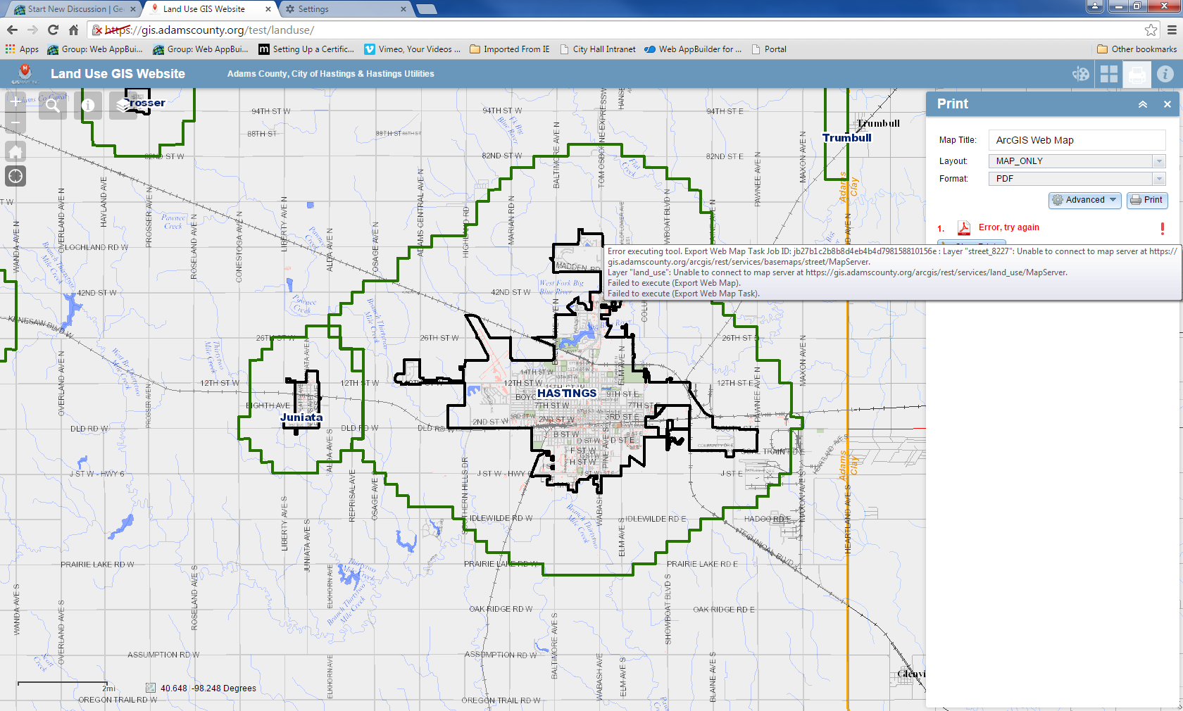

I have the Default Print Widget loaded in my Web App Builder Application and it Errors out when trying to Print while in Web App Builder Developer and when I have it downloaded to my server.  It is saying it can't connect to my map server.  I can access the rest points of my services, and I can view and search them using other widgets within the same application.  I can also access the Print Utility rest point without issues also at https://gis.adamscounty.org/arcgis/rest/services/Utilities/PrintingTools/GPServer/Export%20Web%20Map... .  I do not have my server locked down at all, so everything should be open.  I am using ArcServer and Portal 10.3.1.

When you print a webmap, the user running the ArcGIS Server service actually makes outbound requests to the services you're trying to print, regardless if those services exist on the same machine.  You'll need to capture those requests, so what you can try to do is sign into the Server machine as the user running the ArcGIS Server Windows service, install Fiddler, run Fiddler as the ArcGIS Server user, and then try to print from your webmap.  Fiddler should capture all of the requests that the ArcGIS Server service is making.  Once you can capture a failed request, try to open that URL in your browser and see if it goes through.  It sounds like your ArcGIS Server user can't connect to the service URL you're trying to print, a problem better handled by your IT staff.
LindseyStone
I ran fidler under the ArcGIS Server user and got a couple blocks.  It says the connection to gis.adamscounty.org failed.  System Net.Sockets.SocketException No connection could be made because the target machine actively refused it xx.xxx.xx:443.  The Xs are the static IP of the server firewall.  It cannot find anything packets being blocked on Port 443.  So I am curious if it still possibly be a firewall issue, or a setting within my ArcServer.  I have my protocol for server configured to HTTP & HTTPS.
