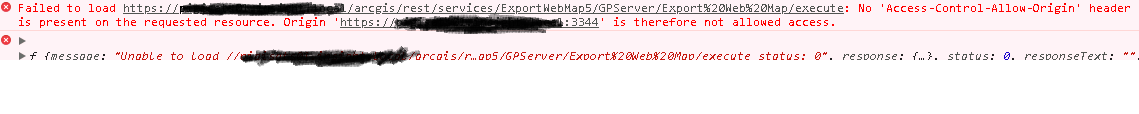

1. It says "No Access-Control-Allow-Orgin" , my mapservice is not secured . I am using the web adaptor URL for print task .
2. ArcGIS Server and application both are running same machine.
3. I tried including this is code (esriConfig.request.corsEnabledServers.push("https://myserver");) in startup function of the widget , same error message I am getting.

   If your map services and print service are using the web adaptor then there would not be the :3344 in the URL. You error like a url with :3344 in the url, so some url in your app is not using the web adaptor url and thus the app see that url as coming from a different machine.
mohannainar1
I am running the application from web app builder that is the reason it is using 3344 , I will host the application in IIS and will let you know the output.
