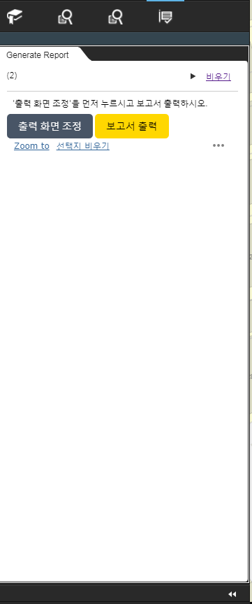

I works great but when I open widgetA from widgetB programmatically, then if I open widgetB, the tab is blank.
here is the before and after screenshot of the widget.
    before                                           after
Thank you.

Bob,
what do you mean by "then if I open widgetB"? Programmatically or from the widget link?
