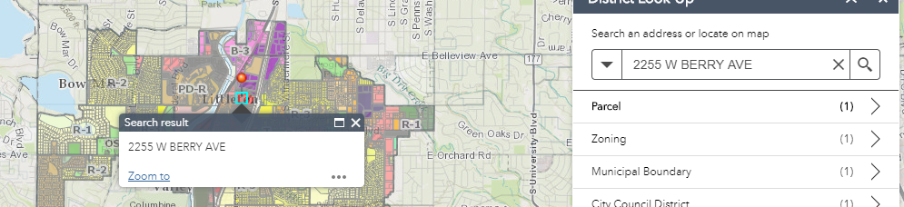

I have inserted a near me widget in my web app builder application. I am trying to get the map to zoom to the searched location using the search tool in the near me widget. Currently the point will populate at the location, but will not change the extent. If I check "Show pop-up for the found feature or location", it provides a pop-up at the location with the option to Zoom To.
I am trying to remove this step, and still have the map zoom to that searched location.

Thanks for the feedback, but I think this only zooms to the boundary the feature is found in, and not to the searched address.
For instance I search for an address point (where I want the map to zoom to and stay). The address is in a few districts such as a parcel, a neighborhood, and a zoning district. When 'Zoom to the selected feature' is turned on, it will zoom to each district the address point is in. So it will highlight the parcel and zoom to the parcel, then on the next tab,  it will  highlight the neighborhood, and zoom to the extent of the neighborhood.
I just want it to zoom 1 time, when the address is searched. I think it correlates to this zoom scale setting,
Using the search tool in the normal search widget this will change the extent when the address is searched, however it doesn't seem to be in the near me widget.
