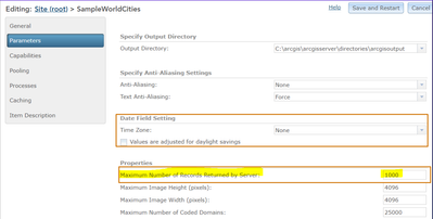

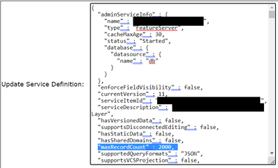

I believe the maxRecordCount of the point layer is 2000. Is the point layer a hosted feature layer or referencing to ArcGIS Server (Map Service/ Feature Service)?
For Hosted Feature Layer, please refer How To: Update the maximum record count for feature services in ArcGIS Online/ Portal  to update the maxRecordCount of the layer.
For layer referencing from ArcGIS Server, you could sign-in to ArcGIS Server Manager > Services > Edit Properties > Parameters.

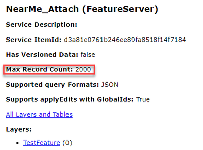

It could be the max record count coming from your service. If you go to your feature service item detail page and from lower right corner where the url is, click view and you should see this information at the rest endpoint. This is the number of features that can be accessed when querying data in a hosted feature service. the default can be 1000 or 2000. I would suggest to check that first
You can increase the limit for your service. here is our knowledge based article that can guide you to do that
https://support.esri.com/en/technical-article/000012383.
