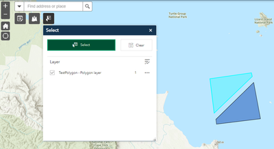

Thank you for your question. Based on the information you have provided, I believe the Select Widget may meet your requirements. This tool allows for multiple features to be selected without displaying a pop-up. I have attached an image with an example of the results below. More information can also be found here: Select widget—ArcGIS Web AppBuilder | Documentation
