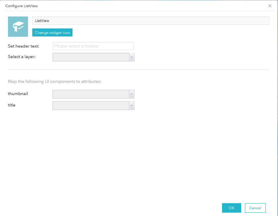

SamLee1
I have tried that and still get an error:
Nothing shows up on select layer, thumbnail, and title. Attached is the modified code based on your 5 lines.
KenBuja
MVP Esteemed Contributor
The order of the require modules doesn't match the order of the function arguments. Since you haven't provided an argument for "dijit/form/Select", you have to move that after "jimu/dijit/Message".

Upon further testing, this.config will also not get created if you add a map that has only a map service and not a feature layer. It returns a value of "ArcGISMapServiceLayer". You can test for this by adding lines 9-14 instead of the test from my last post
array.forEach(infos, function (info) {
  if (info.originOperLayer.layerType === "ArcGISFeatureLayer") {
    options.push({
      label: info.title,
      value: info.id
if (options.length == 0) {
  new Message({
    type: "error",
    message: "There are no valid feature layers in this map!"
this.layerSelect.set("options", options);‍‍‍‍‍‍‍‍‍‍‍‍‍‍‍
Note that this just warns your about not having any feature layers. If you go ahead and configure the widget without the layers, you'll still get that error when trying to use the widget. But then, why would you configure the app to use the widget without any feature layers?
