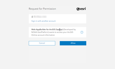

The popup allows me to either use my existing account that I'm running WAB DE or to use another account.
