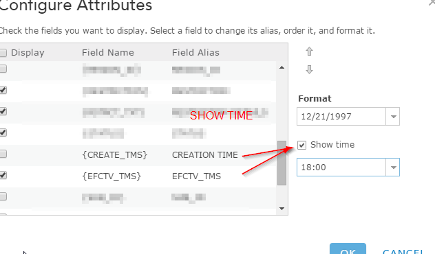

Web Map.  Configuring Popup, you can select to have Time included with Date field (Configuration)
As seen here:
The change would produce the following in a feature popup:

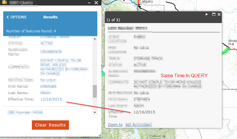

In the Web application Query widget... pointing to the same layer... If a Query is Initiated, the result as well as the Popup when clicking on the result shows the following:  (No Time)

   The query widget produces a layer using the query results and that new layer is not using the popup defined in the webmap, but the one defined in the Query widget UI.
