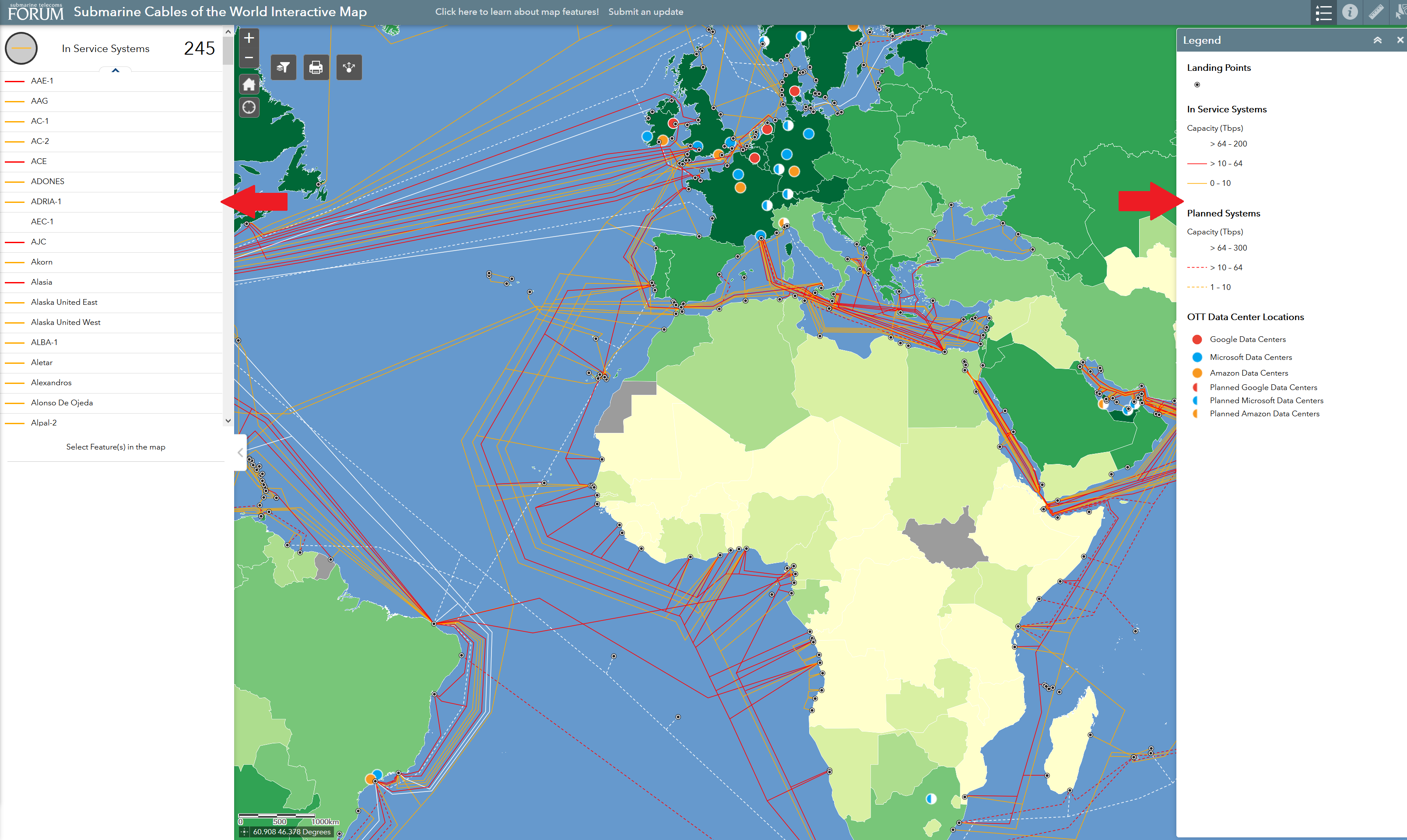

I'm trying to change the color of the panels that pop up when using certain widgets on my web app. We have cable systems in the highest capacity tier colored white so they stand out the most on our map. However, as the background of the Legend and the left-hand layer list in the Jewelry Box theme are white, this color is lost. See image below for what I'm trying to edit.
I just need to know which file I can find the right attribute to change.
FGGEms
Dear Clark,
changing the color in the legend can be done with the jimu.css. There you find the .jimu.widget-frame>.jimu-containter where you have to change the background-color.

Use the picker to find the right places to change in your code: In the following example I changed the color of the legend to lightgrey.

Thank you so much for your reply! I actually figured this out myself late last night when I remembered "Inspect Element" exists and was going to edit my post to reflect that after I got into the office this morning. I'm not a web developer or anything so I wasn't even thinking about it.
Anyway, "Inspect Element" has really helped me out and enabled me to figure out how to change some other design elements we were looking to change.
