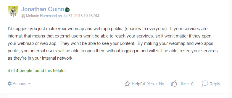

I've seen several threads but it doesn't seem like anyone has come up with a good solution. My apologies if it is out there and I simply missed it.
I'm sure I'm like many users who created a map, published to server, shared to ArcGIS Online, but only shared internally and not PUBLIC. When I made my Web Map in AGOL I did the same thing. I shared it internally with some groups but did not share publically. I did the exact same thing with the app that I created in AGOL for use in WAB (what gives me the App ID).
Once I built my app in Web AppBuilder Dev edition I deployed to my Web Server. Site opens fine but asks for AGOL sign in. How do I configure this so that it does not throw that dialog and allows viewing?
I've tried following all of the proxy docs and the threads I have found and edited the proxy as well as the config in my app. Still no luck. Why is this so difficult? Why is it not on the Esri site somewhere?

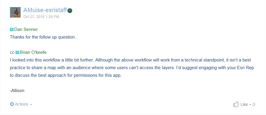

Good Morning Jonathan, I came across the forum post below and wanted to follow up with you.  I had followed the same set up you said in this forum, prior to doing so our IT department had us reach out to our ESRI rep and confirm that this sharing process was in compliance.  Our rep indicated to us that this was and grey area and that it was headed down the wrong path.  I have seen many other users saying they are doing this same process to share maps and apps. Are you under the same impression that this process is a grey area and headed down the wrong path regarding compliance?  Our IT department determined from our ESRI rep response that we should not follow this process.  It would seem to me that maybe others are getting different information because they are already doing this.  Any additional information you could provide would be very helpful.

This is a response that I received yesterday I thought I would share it.
