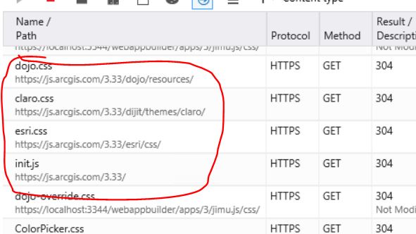

SuiHuang
Hi Robert,
Thank you for the explanation! The solution works for me.
In addition, I checked the network traffic of the site built from WAB, and find that it is downloading the JS API code from https://js.arcgis.com. This explains why I couldn't find the text to update in my hard drive.
Thank you!
