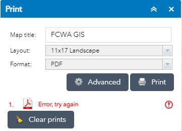

ahargreaves_FW
I'm now stuck trying to configure the Web AppBuilder Print Widget with a custom Print Service URL. As explained above I've followed this documentation and successfully have, and configure, the print widget to use my service URL of:
https://myorg.domain.com/hosting/rest/services/PRINT_TEMPLATES/FCWA_PRINT_TEMPLATES/GPServer/Export%...
However, I get the below error with no further info, even in the portal logs:
LakshmiRajeevKumar
Hi, did you ever figure out the solution. I tried publishing a custom print tool to have some custom layouts but except for the default MAP ONLY layout none of my other layout works.They all show error. In the log it just showed failed to execute the export web map. "Error executing tool. Export Web Map : error raised...2 of the scratch layer paths. Failed to execute (Export Web Map). Failed to execute (Export Web Map). I have tried removing the logos and images and publish but the same error occurs. Somebody please help with this.
