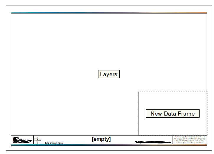

I am trying to create a printing service that can be used in the basic printing widget for an app in webappbuilder, that creates an overview insert map.
Is this possible using AGOL?  I do not currently have Portal.
Below is an example of what my mxd currently looks like, but I can only get one of the data frames to actively show a map when using it with the webappbuilder.

Naomi,
   The only way I know to do this is have your overview map data frame loaded with some static basemap data and in the mxd set the dataframes extent indicator to be the main dataframes extent. I don't know of a way to have the print service send the current WAB map to both dataframes (besides that would really defeat the purpose of an overview if both had the same extent).
