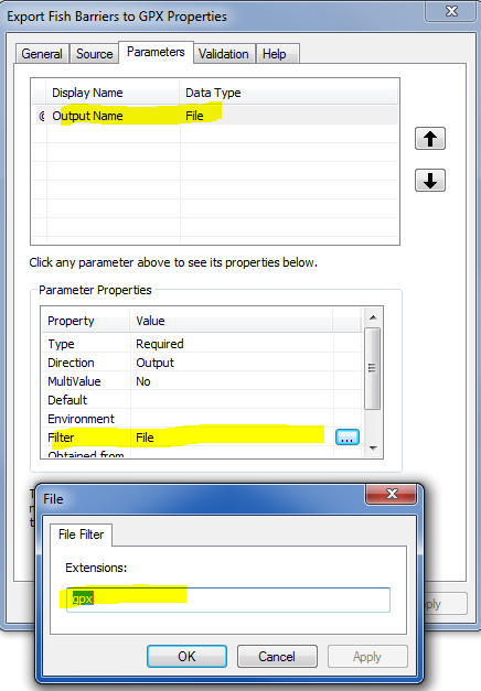

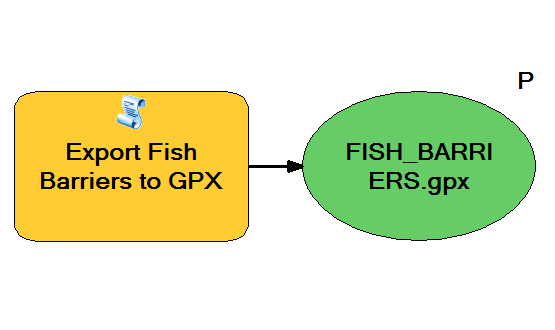

With the python posted below, I have it attached to a model
Which has a parameter

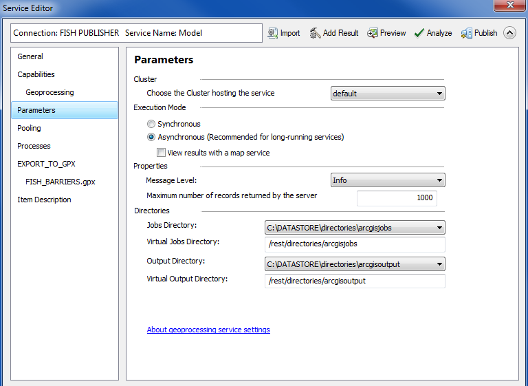

Which runs successfully. I'm also able to successfully publish it as a GP Service.

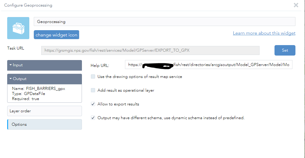

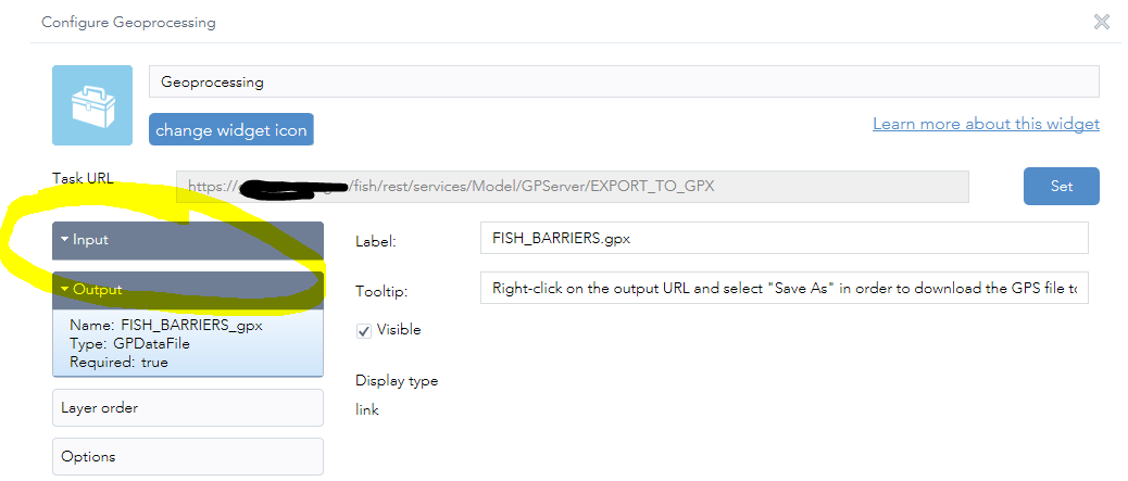

Here's my first problem: Despite having a "Parameter", none is available to the Widget?

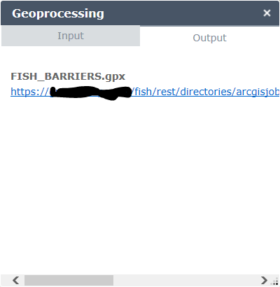

Second problem. When I execute the tool, I get this hungous url. What'd I really like is just the file name as a hyperlink to the full URL. Out of the box, the export web map (print to PDF) GP Tool does this nicely, why can't I make this work with this?

   Maybe I am missing something here but it looks like you only have a output parameter and no input parameters so what are you missing in the GP widget UI that you are expecting to see? The second part of the long url link this is the default behavior of the widget and to modify that you will have to scour the code and find where the html anchor element is created in the widgets results and assign a different string instead of the complete url.

Yup. That was the trick. By attaching this to a WAB GP Widget, and editing line 55 of resultRendererManger.js as such:
        text = '<a target="_blank" href="' + value.value.url + '">Get My Data</a>';
I'm able to do this:
