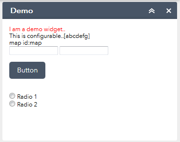

The button looks like I want, but the numpickers just looks like ordinary text inputs, and so does the radiobuttons...
This is how it looks:

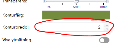

I want the numpickers to look like they do for example in the drawWidget:
