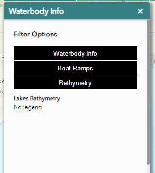

I have done this before without issue, but for some reason I cannot get my legend to show up in a div element I created in a widget panel. I have looked a all of the esri documentation to try and figure out what's wrong and cannot find anything, so I need some help to figure out what I am missing. I have a custom widget and I just want to show the bathymetry symbols in a legend for a bathymetry layer. Here is my code:

I thought maybe it was a css issue, but I made sure the div element is set to display: block with height and width set, so that's not the issue. For some reason the legend isn't loading. I should be seeing two child nodes after logging out the legend, but I am only seeing the 'legend-div_msg' node.

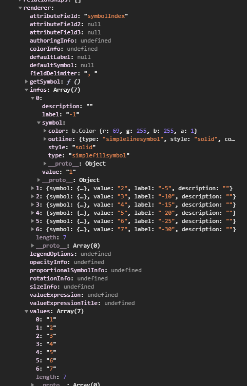

The only thing I can think of is that it is a timing/async issue, but I was under the impression that the legend used the layer render to set the legend symbols and if that's the case, the renderer exists since it is being access from the url and so the legend should have access to the symbols. Everything seems to be in order here:
