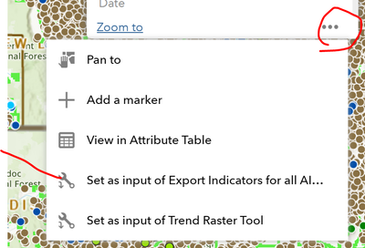

How do I config the Set as Input to of in the ... menu of popups for the Geoprocessing widget?

How do I config this list?
Cannot find any help or why it lists some tool and not others?

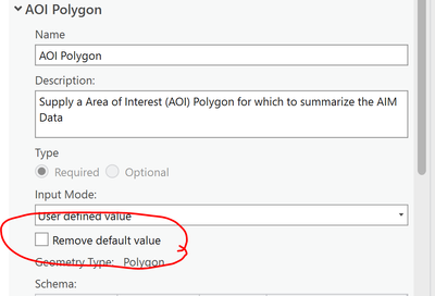

I figured it out.  This new checkbox to Remove Default value in Pro 3.3 while publishing a GP tool totally breaks the ... menu.  That is a weird one and must be a bug.  Also note you must manually set the Input mode above that to User defined value.  And it will flip back to Choice List every single time you overwrite as it flips back all the time.

Still cannot find this.  Tools seems to add and remove from the list at random.

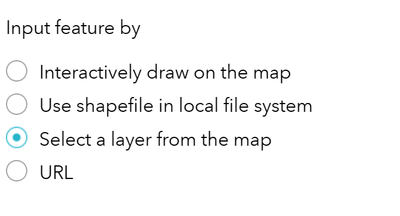

I also wonder why this list is not a checkbox vs a radio?
In Pro for that exact same tool we can pick a layer, add from file, or draw.  I thought at saw this before in WAB but we cannot get it.
We had a demo for users all setup and then the tool we wanted disappeared from the Set as input list and we cannot figure out why.
