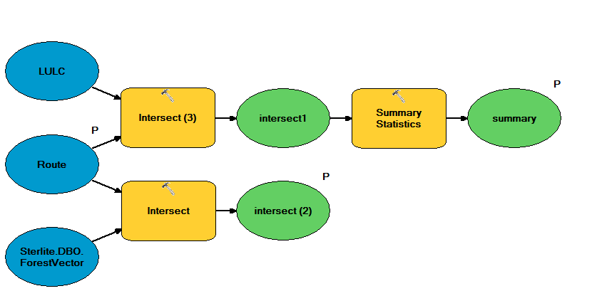

I have developed a geoprocessing service as below.

This model works completely fine on ArcMap but I get a null result when I execute through web app builder. Can someone please help me understand where I'm going wrong.

  So is the input geometry a point or a polyline? When it works in ArcMap what is the spatial reference of the input geometry? I don't like helping on GP widget stuff because people normally say it works in ArcMap but not in X. Well there are many things that would possibly prevent it from working in Xand yet work in ArcMap just fine. There is the whole scratch workspace thing and several others. But is could just be that you are just not getting the input param correct.

Secondly, I have just one param which is a result set for that I'm simply passing my result from a query as mentioned above and spatial reference is the same as my data, so I don't see a problem there.

  So I don't see the issue either then. Does the GP create a featureclass or anything server side? Have you checked the server logs for clues as to what is going wrong?
akshayloya
It returns a table and a feature class. No warnings or issues in the logs. I'd checked that.
