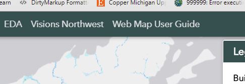

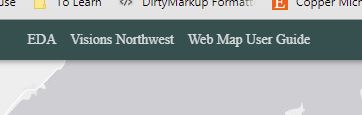

I am trying to figure out why my font, in a Web App Builder project, is changing when I move an app from being hosted in AGO to our in-house web server. I have attached two .jpgs showing the font difference (1) is AGO and (2) is our web server (IIS). The text in question are links generated in the "Attribute" tab of WAB, using the Foldable theme.
(1)AGO hosted
(2)web server
If anyone could explain what is happening here and how to remedy it, it would be greatly appreciated.

Clement,
   You do not have the woff mime type added to your web server.
Set mime types for web fonts in IIS » Coding Still

That did the trick. Thank you so much, Robert. That had been bugging me for days.
