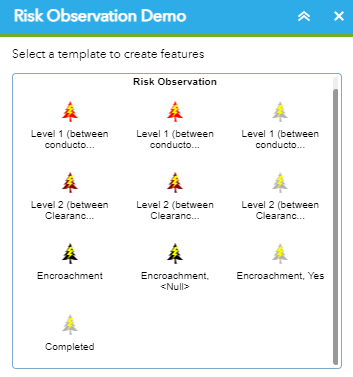

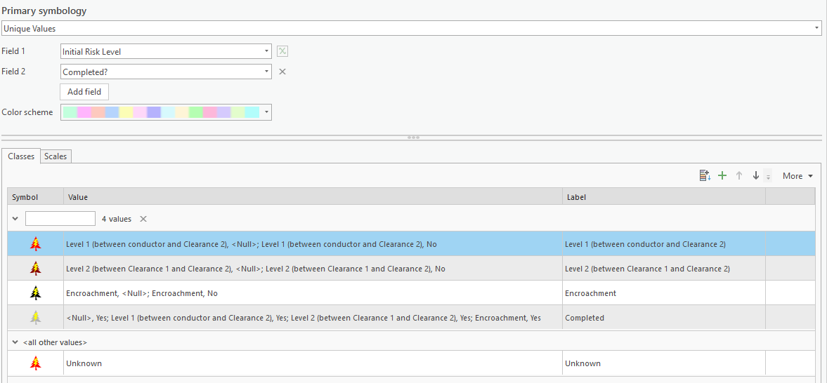

I am wanting to get the web app builder for developer (v 2.17) smart editor widget to only show a subset of feature templates.
The problem I am having is shown below.
I have a feature service that is symbolized using two fields. I have then grouped values to get the layer to symbolize the way I want.
When I add this layer to the editor widget I get a bunch of templates that I don't want to present to users.
Is there a way to hide some of the templates so users are unable to select them when creating new features?

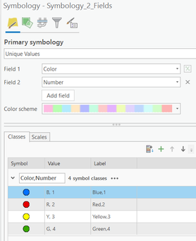

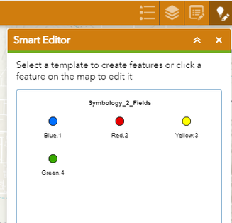

Hi @MarkEastwood ,
I've tried a similar workflow on my end and here's what I observe:
It appears I am getting the correct templates in the Smart Editor:
Do you recall making any changes to the layer symbology before or after adding it to the Web AppBuilder application? Sometimes this may affect the way the templates are displayed in the Smart Editor widget.

MarkEastwood
Hi @AlixVezina,
Thanks for your response. It looks like your workflow is similar but your grouped values are a bit neater then mine. My grouped values have multiple options (Encroachment, <NULL>; Encroachment, No) where yours only have one (Blue, 1).

AlixVezina
You are correct, my test was incomplete, my apologies.
I've tried this again and added more combinations, which would get closer to your configuration I believe. It appears the symbology I've set in ArcGIS Pro still aligns with what I see in the Template Picker.

MarkEastwood
Hi @AlixVezina,
I still think your test is missing one key component. None of your symbology classes are being grouped like my setup has it. You have unique values set up on multiple fields like I do. But after that is configured I have grouped some of the values.
For example, some of my existing data has values like (Encroachment, <Null>) and (Encroachment, No). I have grouped these values cause they mean the same thing to my users. Moving forward, I only want them to be able to add new features assigned to (Encroachment, No). Which is why I want to hide some feature templates from the Smart Editor widget.
I realize that I can clean up the data so there are no nulls but having the symbology set up the way I do is what my organization wants.

AlixVezina
If my understanding is right, this is the step I missed?
MarkEastwood
Yes @AlixVezina that is the step you missed. If you add that to the Smart Editor (B, 1) and (B, 2) will show up as templates. Which makes sense but I was wondering if it was possible to hide one of those templates from the Smart Editor.
AlixVezina
Right!! I follow now, I'm sorry it took so much back an forth. I thought the templates were showing unexpectedly.
Short answer is no, you cannot hide templates without customizing the code for the template picker, for which I provided more details in an above comment.
