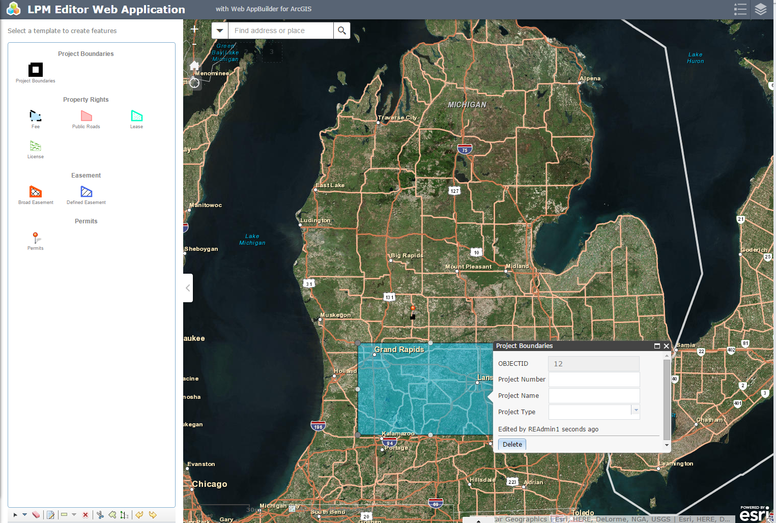

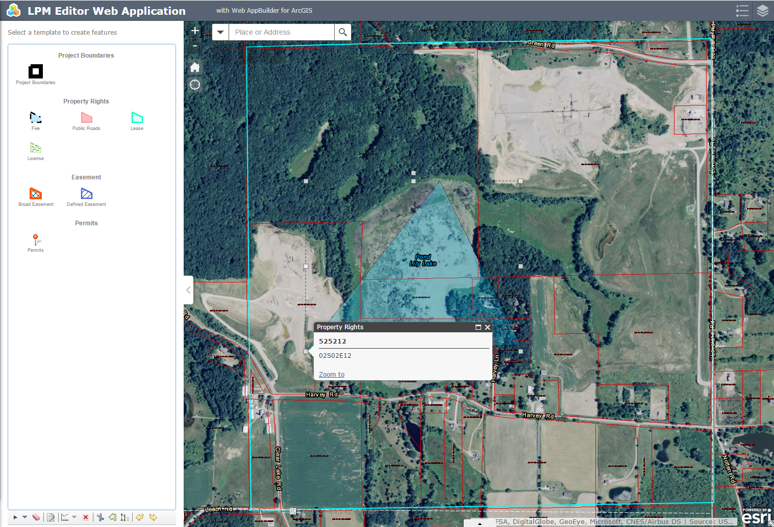

I am trying to use the Jewelry Box Theme with the edit widget. When I search to a location then try to add a feature to the map the attributes from the search are added to the pop-up instead of the feature attribute pop-up.
Is there a way to fix this?
It should look like this:

Sorry for the inconvenience caused. We have fixed it in Online3.9, for Developer Edition, we will fix it in the next release(v1.3). As a temporary solution for Developer Edition v1.2, please use attached file to instead of "arcgis-webappbuilder\client\stemapp\widgets\Edit\Widget.js"
If you want to continue edit the feature after searching, you just need to click Edit Widget again to activate it.
