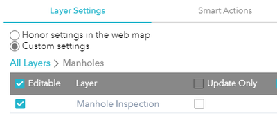

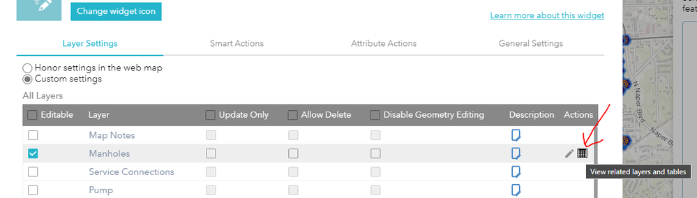

Make sure to click the related table icon under Actions, and to enable Editable for that related layer.
Example:
Example:

Hi Alix
thank you so much, I was trying to relate them one by one but now I have relate the Boundary to the layers then from there I relate the tales and it is worked.
