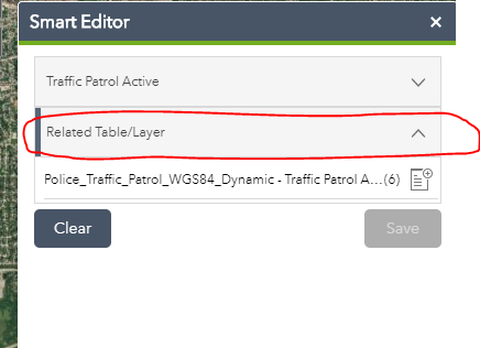

Hello all !!
My Organization has a Web App Editor set up for our Police department to edit Traffic data.  The data-set has a related table attached to it.  I am wondering if it is possible to click a point on the map, using Smart Editor, and have only the Related table come up to be edited  (see pic below) ?? The idea is to simplify the process so the Officers don't have to spend the time to find the place where they would enter the new Related table entry.
Thanks for your help.
Jarrett

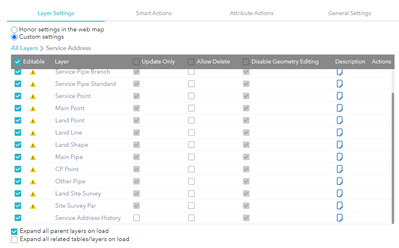

An enhancement in the Smart Editor widget should now allow you to do this.
In the widget configuration, check the box for Expand all related tables/layers on load.
When clicking a feature on the map, the fields for the parent feature will be collapsed and the available related records will be shown expanded. The record itself won't be open, so the user will still need to click on a record to edit it, but this still removes a few clicks for the person editing related records.

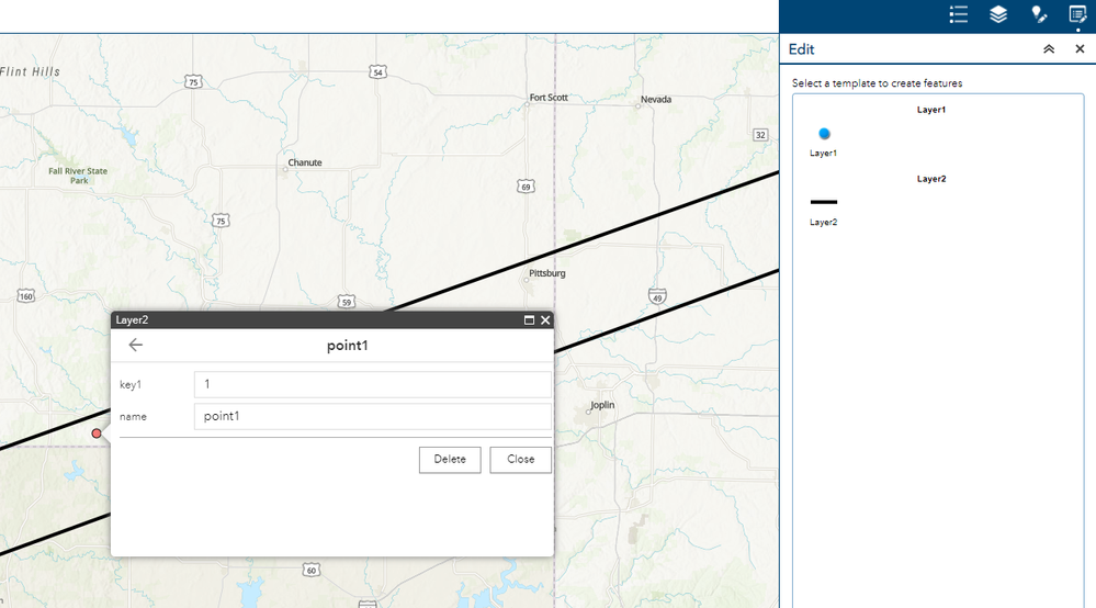

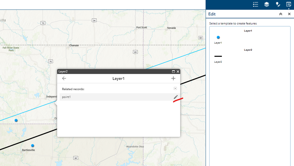

Perhaps the Edit widget will be more appropriate for your workflow as it will allow you to edit the geometry of a related feature from its source feature?
For example below, if I click to edit the Line layer, the related point feature is listed in the edit pop-up.
And if I click through, I can now edit the point feature.
