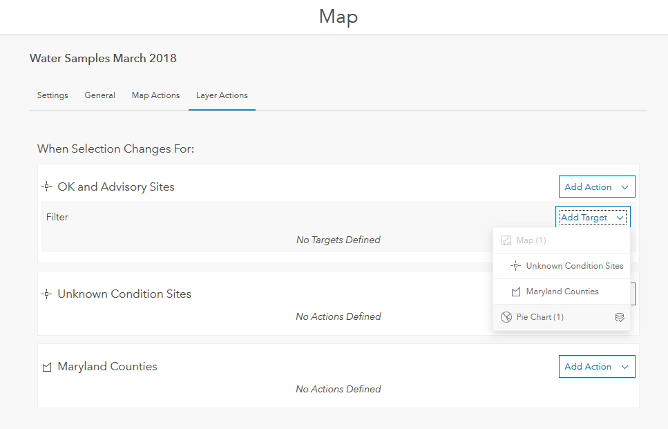

This can be done using the following workflow:
1. Go the to configuration dialog of the Map element > Layer Actions
2. Select the layer in the web map that you want to apply the action from (i.e., the layer where you will enable the feature selection) and select Filter from the Add Action dropdown list
3. Then select the dashboard element you want to apply the filter to, from the Add Target dropdown menu.
4. Then click Done.
When you select a feature from the layer, it should apply a filter on the assigned dashboard element.
