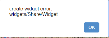

I'm having the same issue with custom widgets- using WAB 1.1.  In using Robert Scheitlin, GISPwidgets, only the basemap widget works without any issues.  Share and Elevation Profile will throw this error.  Other custom widgets also seem to throw the error as well.
RobertScheitlin__GISP
MVP Emeritus
Christopher,
   Did you add the new widget to your client\stemapp\widgets AND your actual apps copy of that widget
server\apps\xx\widgets?

Do you see anything in your browsers web console.
ChristopherOlsen
panel [widgets/Share/Widget_19_panel] created.
WidgetManager.js:101 create [widgets/Share/Widget] error:TypeError: Cannot read property 'remove' of null
MVP Emeritus
Christopher,
ChristopherOlsen
That was it.  The folder was in there, but once I overrode the old files, the issue cleared up.  Thanks Robert!
