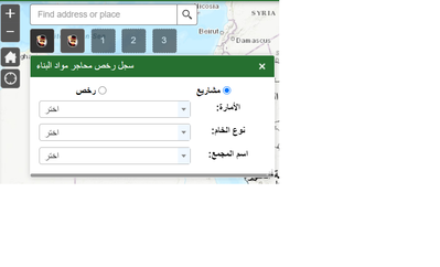

Dear All,

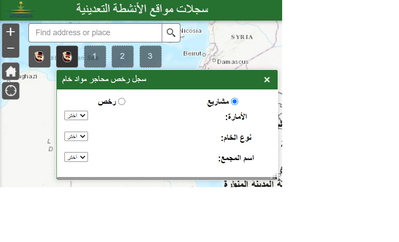

i have two widgets.Both are getting css files from same path.i have three jquery select2 drop downs on each widget.when i  publish the widgets.i see some strange behaviours.which widget i open first.it shows all the css rules apply on it.But the second widget does not show any css rules on select2 and vise versa.you can see on the given images.
  what can be the reason.please help.in image 2 it seems select2 not defined.because drop down shape is like normal select.
Nadir_Hussain
Dear All,
  i find the problem and solve this issue.i dont know weather it is the bug in arcgis web app builder.both widgets have same ids of controls.i just change the ids of controls and it start working.
Thanks 2 all of my friends.
