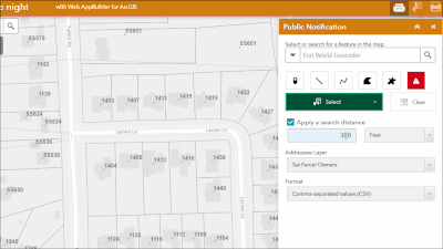

I'd like to create a custom print service that uses a report template configured to pull the results of the Public Notification widget in one of our ArcGIS Online apps. I'd like to pull the value used as the "Search Distance" and one or 2 fields from the "Subject" feature as the header, and then a table of the parcels that intersect the buffer with several of their attributes.
In this image, the orange property would be the subject, and the blue properties would be the intersecting features.
I have created a Report in ArcGIS Pro, set up the look the way I want it and got the table to pull values from a selection I did in a Pro map. Right now the header data is all plain text except the dynamic date. I'm hoping it is possible to use tags or something to pull the necessary values from the Public Notification widget.

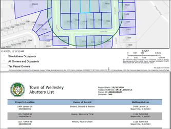

  1. a sample output pdf containing a map and abutters list that will looks like this

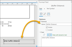

  1. In layout template file (.pagx)
    • added a new text element
      • that is outside of the page to make sure it does not show up in the output
        • the report generation process use this later
      • this is named "{Buffer Distance}" - note it is embedded within a setup of curly braces
        • :warning: if you ever change its name, you need to update the python code
      • you will see later how and where it shows up in this workflow
    • if you want to use your own layout, that is okay, just make sure (a) it has one text element like this one, and (b) the pagx file must be named same as the rptx file

      • now wait.... hopefully it will work fine on your side and you will get a pdf containing a map and abutters list 🙂
