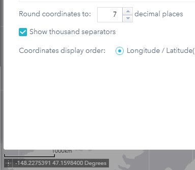

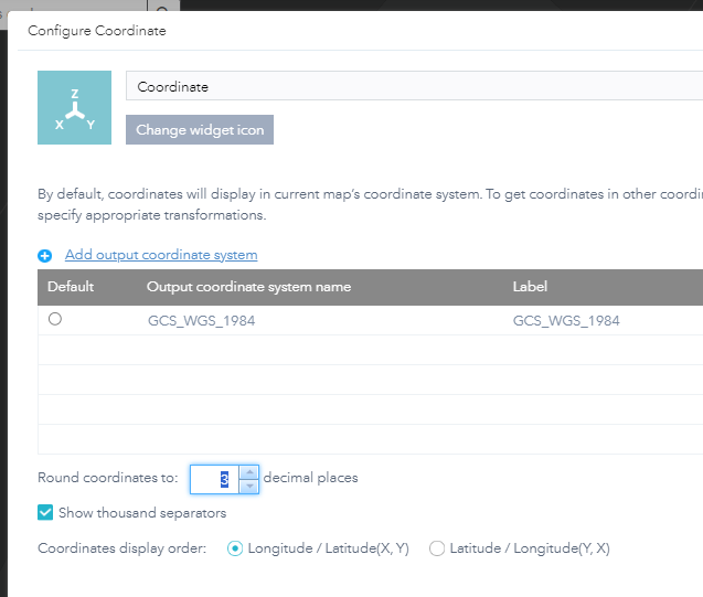

I'm trying to enable my colleagues to capture more precise locations (building level asset locations etc.), but the coordinate widget does not respond the precision parameter I've set.
Any idea what I'm doing wrong here?
Result of the above settings:

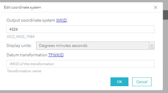

Hello @Sam_Keast , it seems that the Round Coordinates to x Decimal Places setting only has an effect when you are also using Display Units that are Decimals, as opposed to units such as Seconds.
