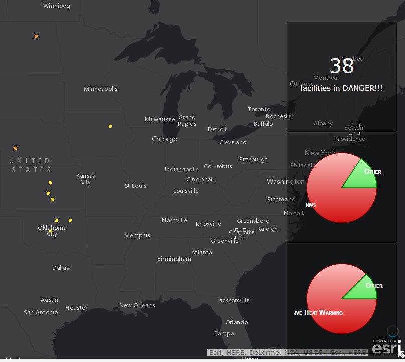

I have been developing some custom widgets and functionality to get some charts and data to show up on the side of the map (see attached image).  I am getting this strange error when opening my app, which is:
create panel error: Error: Tried to register widget with id==_33_panel but that id is already registered, panelId: _33_panel.
Ultimately, I'm confused on how to create a group, panel, and widget configuration so that the widgets open simultaneously without issue.

So my question is am I getting this error because the app is trying to open three EONBorderPanels at the same time with the same id?  Is that why I'm getting this error?  And how to I prevent it?
Any help would be appreciated!
