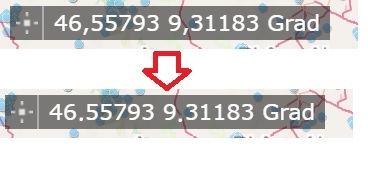

Hi,
is it possible to change the seperator of the coordinate widget of the WebAppBuildert from , to .? I've allready scrolled through the widgets/Coordinate/Widget.js file, but it looks like I'm just to bad with Java script. Is there anybody who could provide some tips here?
The link to the running webapp:
https://wasserwiki.eu/Wasserwiki_App/
KenBuja
MVP Esteemed Contributor
This is dependent on the machine's locale setting. On my machine ("en-us"), it shows as a "."
However, if I use a locale URL setting with your app (https://wasserwiki.eu/Wasserwiki_App/?locale=FR-fr), it shows ","
Wasserwiki
That does make sense. Thanks for clarifiying. Is there a way to prevent the app from switching to the comma seperator, as the most apps, even in europe, use the point format?
