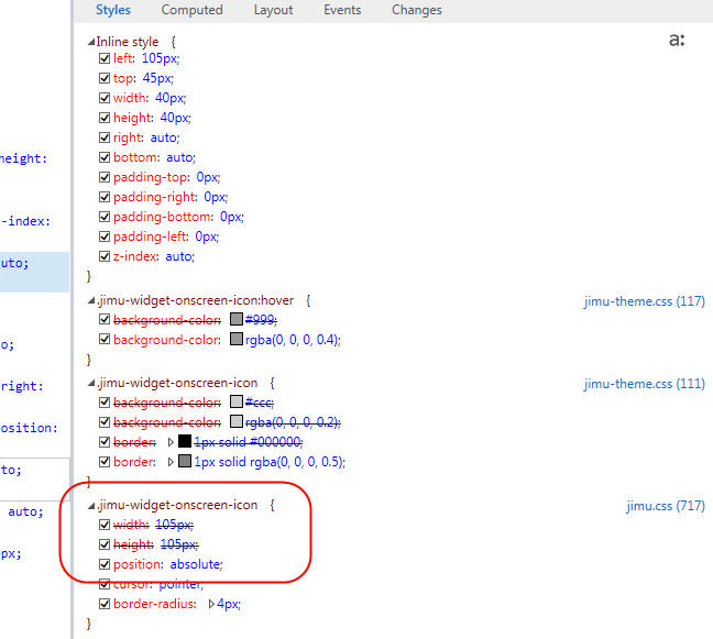

hello,
I'm sure the developers are probably tired of us mucking in their code, but I really want to make my on-screen icons bigger.
I found where to change the size of the image within the icon, but not the icon itself, it gets overwritten from the 'Inline style'
this is in ~\jimu.js\css\jimu.css
/*css for PreloadWidgetIcon dijit*/
.jimu-widget-onscreen-icon{
  width: 105px; /*added*/
  height: 105px; /*added*/
  position: absolute;
  cursor: pointer;
  border-radius: 4px;
.jimu-widget-onscreen-icon img{
  width: 80px; /*changed*/
  height: 80px; /*changed*/
  margin: 10px;
if there is some easy code to change, please let me know, thanks.
