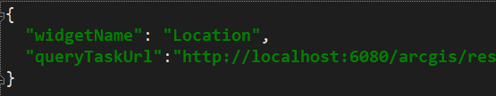

in the config of widget is this:
but ,in debug is this:
2.png,
,so, please help me,thanks!

   Is your manifest.json set to know that your widget has a config.json?
"properties": {
    "inPanel":true,
    "hasLocale":true,
    "hasStyle":true,
    "hasConfig":true,
    "hasUIFile":true,
    "hasSettingPage":true,
    "hasSettingUIFile":true,
    "hasSettingLocale":true,
    "hasSettingStyle":true,
    "IsController":false,
    "hasVersionManager": false
Is your config.json in the same folder as the Widget.js and named "config.json"?
