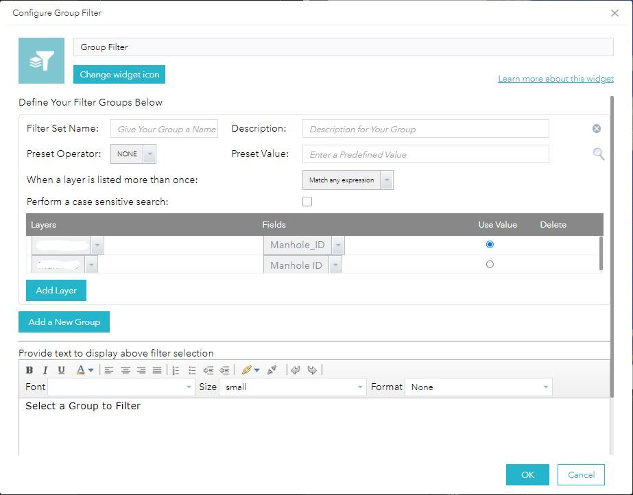

The group filter widget can have two different feature layers where the corresponding shared values can be filtered based on a specified value.
