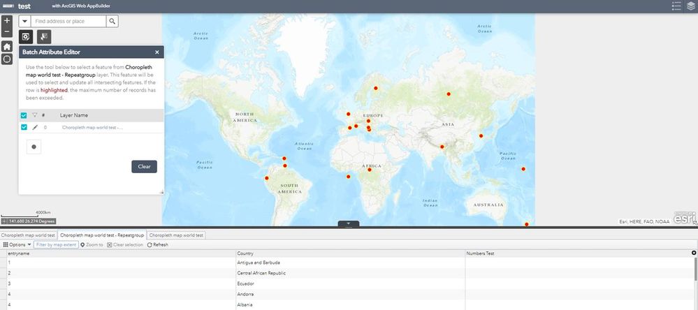

Additionally, the main chunk of my survey data is in a repeat layer of the survey. I have been trying to test out the Web Appbuilder and the Batch Attribute Editor widget, but the repeat layer is not showing up on the widget configuration page for selection at all. Any idea what I might be doing wrong, or is the Batch Attribute Editor not compatible with repeat layers?

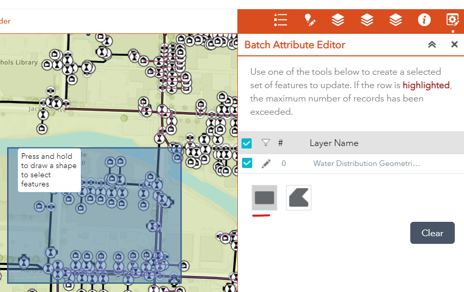

# 3 says choose a tool or a feature to draw on the map. I added the ‘Select’ widget for selecting features
I believe the selection of features has to be performed using the selection tools within the Batch Attribute Editor widget, and any selections you've performed using other widgets (e.g. Select widget) are not used.

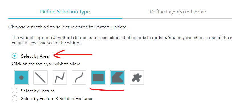

Based on your screenshot, I think you may need to make an adjustment in the Batch Attribute Editor widget configuration. You will want to enable the option to Select by Area, with the tools to be used for the selection.
Then, when using the widget, you can use these selection tools to select the points to be edited.

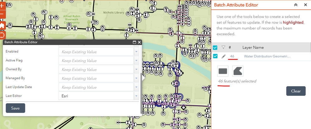

This will then display a pop-up window for editing the attributes of all the selected features.

Thank you for sharing! Based on your XLS, I see there is no Geopoint question. Is your repeat layer a related table? Technically, the Batch Attribute Editor widget only supports layers with a geometry that can be found in the web map (so no related tables).

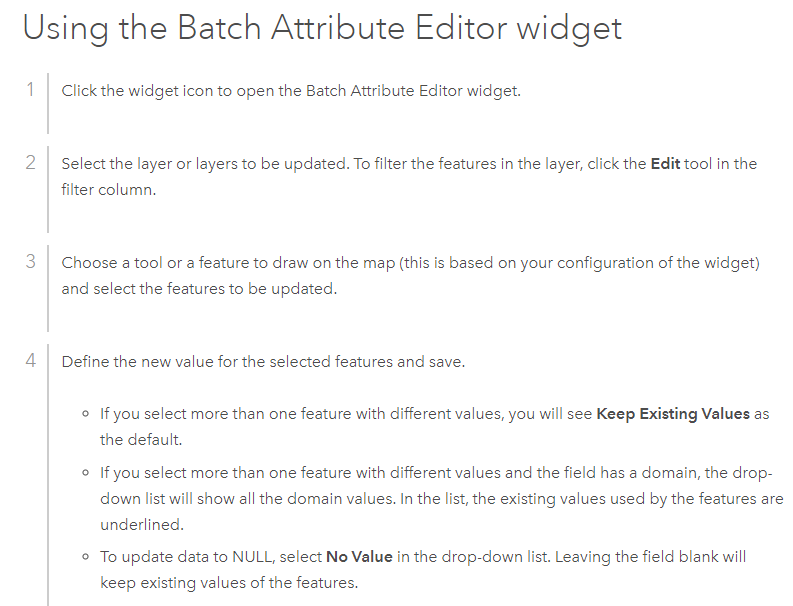

I’ve tried using this documentation page, but with no luck so far. https://doc.arcgis.com/en/web-appbuilder/create-apps/widget-batch-attribute-editor.htm
#2 says ‘click the Edit tool in the filter column’, but there are no ‘filter column’ shown in the Batch Attribute Editor tool. Although I can choose the edit button and apply a filter there via ‘add expression’.
Once I apply the filer, # 3 says choose a tool or a feature to draw on the map. I added the ‘Select’ widget for selecting features – but when I use this widget on the map extent, it removes the filter applied by the above step.
#4 says ‘define the new value for the selected features’ but there are no sections in the Batch Attribute Editor or anywhere else on the Web AppBuilder page that lets me enter a new value for a specific field for the batch-selected features.

Ahh this is perfect, thank you so much for your help! 🙂 I thought that since I'm selecting only by specific value of a specific field (rather than selecting by location) I had to use the select by feature. Thank you again, this is really helpful!
