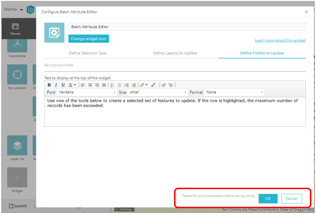

I am having in issue that I've been working on and can't find any answers to. It is with the WAB (not sure how to verify the version, I looked for the ol' Help/About but didn't see it). I've been working with both current FireFox and Chrome, but no joy.
Basically I can't save my configuration for the Batch Editor widget. It just tells me that I need to finish configuring before I can save.
I have tried changing every single option but to no avail. I have searched the world over and found no other instance of this happening. There are plenty of issues with this widget, but I seem to stranded here.

Hi @BillHeigh,
For this widget to work as expected, please make sure the layers you have selected in the "Define Layer(s) to Update" tab have common field names. Only common fields from the layers you've selected will be listed in the "Define Field(s) to Update". You can then select the fields you would like to batch update from there and save the configuration. The widget configuration cannot be saved if no layers were selected and no fields were selected. If you select only one layer to update, the fields should be listed as well.

PeterGoedbloed1
Hi @AlixVezina I am running into the same issue. Although I want to ultimately have the Batch Attribute Widget to look at two layers (that share the same field though). I keep getting the 'No common fields' message even if I select just one layer. Should the field meet certain criteria to appear for selection? I have a text field with a domain that I want to use.
PeterGoedbloed1
I just made a screencast to demonstrate the workflow: https://www.screencast.com/t/OT5JIqYK

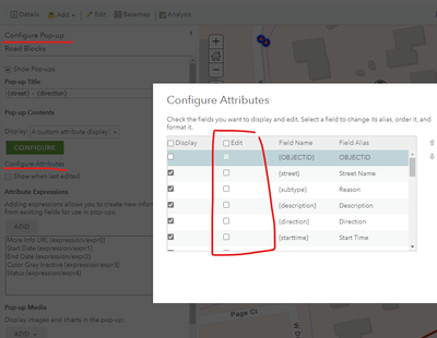

The only thing I can think of is to verify in your web map to make sure the fields you would like to update are set to be editable in the pop-up configuration?
