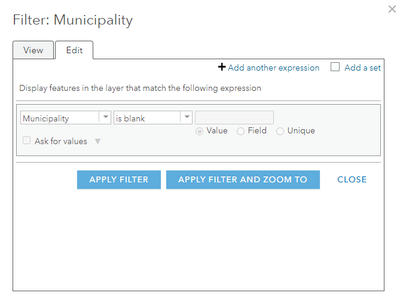

It would be ideal if I could figure out the action that would allow this functionality within the group filter widget, but I did discover a work-around. Though, it does have some limitations.
Within the web map, if I filter the boundaries to be 'blank', I can then choose the option in the app's group filter 'Append any expressions to existing map filter'.  This will turn the layers on only when I use the group filter. The only drawback to this solution is that users will not be able to turn on these layers without using the group filter.
