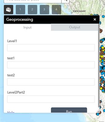

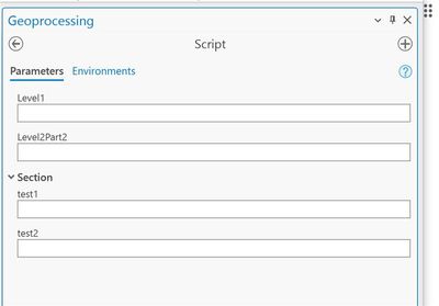

Any way to get Toolbox Categories to work in the GeoProcessing widget?
Works in Pro
But not in the WAB widget.
Or any other idea to break up a tool with several inputs?

Doug, I've never used the OOTB Geoprocessing Widget for WAB but I've made extensive use of the JSAPI
 "esri/tasks/Geoprocessor"
 to get stuff from a web app into a custom GP or print service. If you're able to create a custom widget (pretty straight forward), you can pass in all kinds of info that way whether it's information about the current map status or user provided info via HTML inputs. Not sure what changes there are in 4.x versus 3.x as I'm just now in the process of migrating things. But if you're in WAB, you're using 3.x and that's what I used.
If you already know all this, and it doesn't answer your question. then I apologize. Haha.
