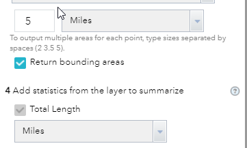

Hi, I am trying to change the default unit for
They are currently set to Miles and I want to change it to KM.

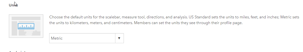

My organization is set to Metric

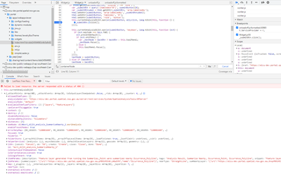

In Widget.js -> _switchToAnalysisTool, I also tried to set the unit via the arg which works for create buffer.
Any suggestions?

VictorTey
Hi @RobertScheitlin__GISP  I have not idea how you know that but it works. I had a break point on the submit hoping to see it in the argument but I don't see units there.  Did you know to use units from the rest endpoint ? Again thank you so much 🙂
