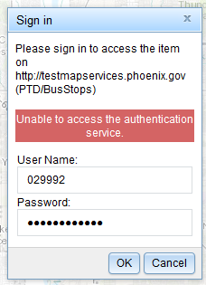

I have a secured feature service. Using our organization AGOL account, I've added the feature service using the map viewer configuration and then creating an application with the new GeoForm template. The feature service asks me to sign in and I do so with no issues. When I try to create an editing application with the Web AppBuilder, the secured feature services asks for my login and then presents the following error: "Unable to access the authentication service".  Why would I be able to access the secured feature service one way and not the other?Error.png

We have the proxy set up and I can see the AGOL services just fine. My issue is that while on AGOL using the WAB tool, I can't configure secured services on our servers. ESRI has logged the bug: [BUG-000082858: When using a secure service with Web AppBuilder, receive the message “Unable to access the authentication service” whenever credentials are provided during the configuration phase].
The work around is "When using either Chrome or Firefox, if you navigate to the REST endpoint of your secure service and sign in with your credentials, the service will display if you return to configure Web AppBuilder."

After contacting ESRI support, it appears I have found a "bug"! Resolution time estimated: Unknown.
