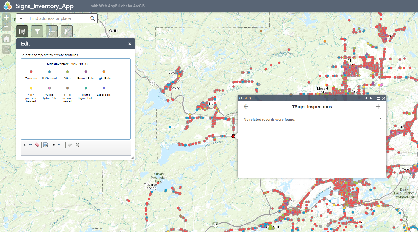

Not sure about portal or server but I have it working in AGOL using the edit widget.  My sign inventory and inspections tables now show a plus sign and I can add related records.App window - Sign InventoryApp window - Sign inspections

It looks like this is now working for 10.6.
I am able to add a related table record.
