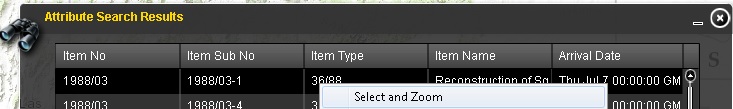

In my flex application, I have a function to retrieve feature attributes in a datagrid.
In the datagrid, I add a context menu "Select and Zoom", when click this context menu on a selected row, I need to select and zoom to the feature based on the "Item No" and "Item Sub No" value.

But got "RPC Fault 400" warning as displayed here:
Thanks a lot for the help.
